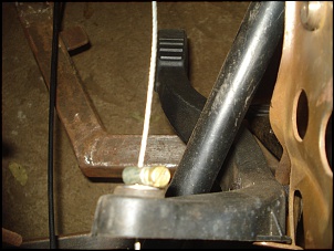

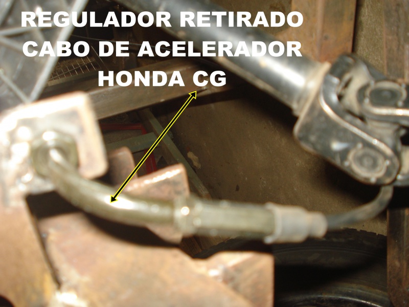

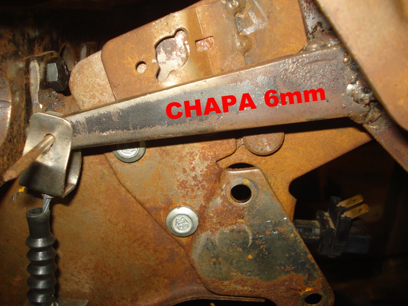

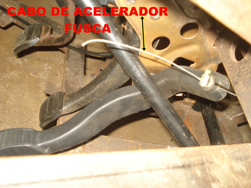

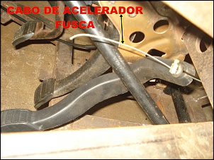

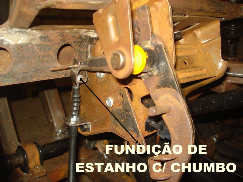

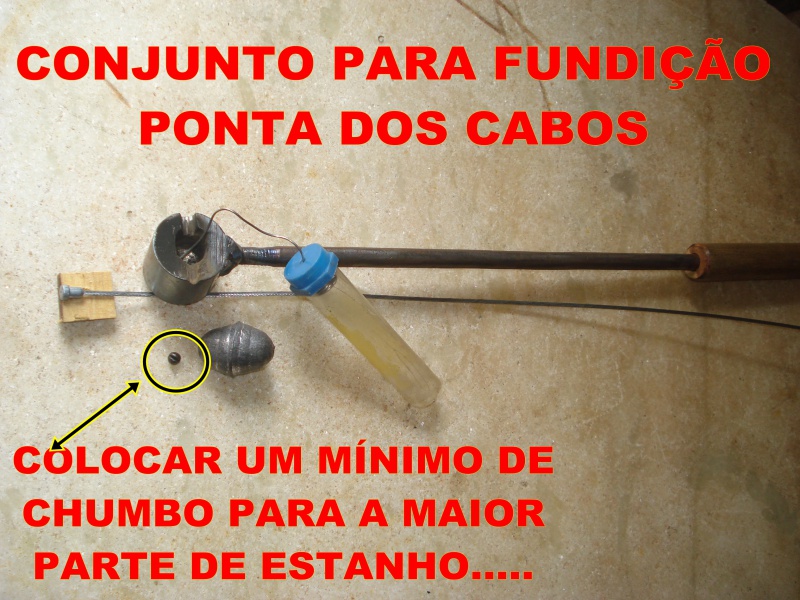

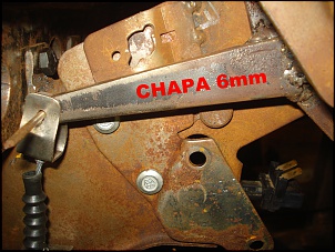

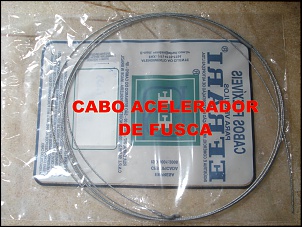

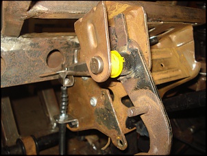

  • #316

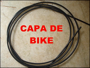

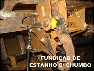

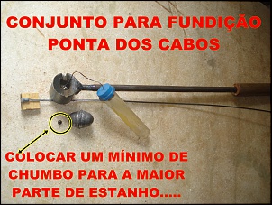

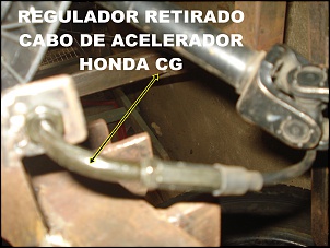

    AE GALERA! MEU SISTEMA CAIPIRA DE ACELERADOR KART CROSS kkk
    Kart cross /catanduva-sp/junior ferrareze-bb1.jpgKart cross /catanduva-sp/junior ferrareze-bb2.jpg
    Kart cross /catanduva-sp/junior ferrareze-bb3.jpgKart cross /catanduva-sp/junior ferrareze-bb4.jpg
    Kart cross /catanduva-sp/junior ferrareze-bb5.jpgKart cross /catanduva-sp/junior ferrareze-bb6.jpg
    SEMPRE FAÇA O MELHOR ACABAMENTO QUE PUDER!
  • #317
    KART CROSS
    CONJUNTO DE ACIONAMENTO ACELERADOR

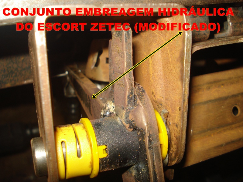

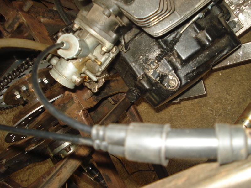

  • #318

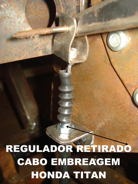

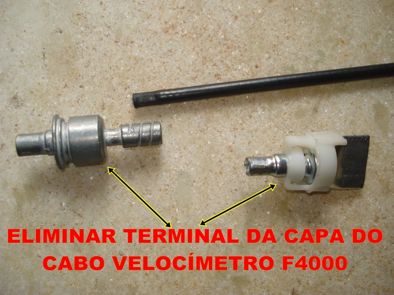

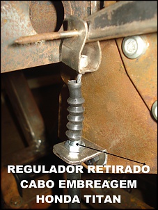

    AE GALERA! MEU SISTEMA CAIPIRA DA
    EMBREAGEM
    KART CROSS kkk
    Kart cross /catanduva-sp/junior ferrareze-aa1.jpgKart cross /catanduva-sp/junior ferrareze-aa5.jpg
    Kart cross /catanduva-sp/junior ferrareze-aa2.jpgKart cross /catanduva-sp/junior ferrareze-aa4.jpg
    Kart cross /catanduva-sp/junior ferrareze-aa6.jpgKart cross /catanduva-sp/junior ferrareze-aa7.jpg
    Kart cross /catanduva-sp/junior ferrareze-aa8.jpgKart cross /catanduva-sp/junior ferrareze-aa9.jpg
    Kart cross /catanduva-sp/junior ferrareze-aa10.jpgKart cross /catanduva-sp/junior ferrareze-aa11.jpg
  • #319
    KART CROSS
    CONJUNTO DE ACIONAMENTO EMBREAGEM
    2016 TERMINO MEU KART CROSS hehehe!
