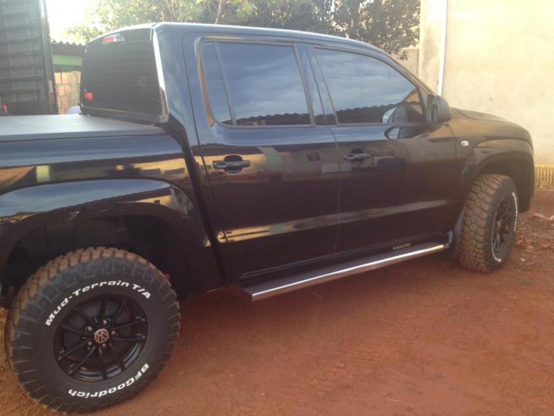

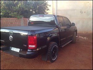

    Amarok Mud
    Fotos da amarok Pneus Mud-912385_367694946676090_487381149_n.jpg-912147_367695573342694_983497962_n.jpg-912006_367695496676035_758903801_n.jpg-908396_367695093342742_2120662884_n.jpg-912385_367694946676090_487381149_n.jpg-912147_367695573342694_983497962_n.jpg-912006_367695496676035_758903801_n.jpg-908396_367695093342742_2120662884_n.jpg-912385_367694946676090_487381149_n.jpg-912147_367695573342694_983497962_n.jpg-912006_367695496676035_758903801_n.jpg-908396_367695093342742_2120662884_n.jpg
