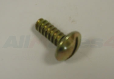

    320045 | FLOOR SCREW FLAT HEAD S1-111 | PARAFUSO CABEÇA CHATA DO ASSOALHO
    SE106201L | SCREW M6 X 20MM | PARAFUSO DO ASSOALHO (LATERAL DAS PORTAS)

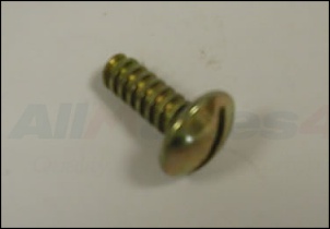

    AB614061L | SCREW NO14 X 3/4 SEF TAPPING | PARAFUSO DO ASSOALHO

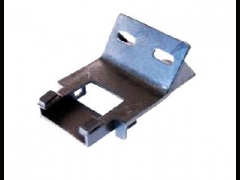

    MWC3136 | SNAPSAC FOR DOOR TRIM DEF | TRAVA FÊMEA DO FORRO DAS PORTAS (LADO DA LATARIA)

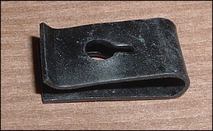

    MWC9322 | NUT SPRING TYPE NO6 | CLIP COM ROSCA PARA PARAFUSOS (Usados em vários locais)
