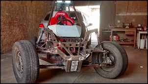

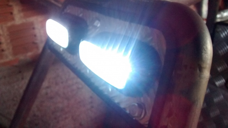

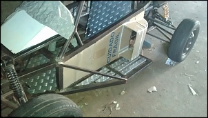

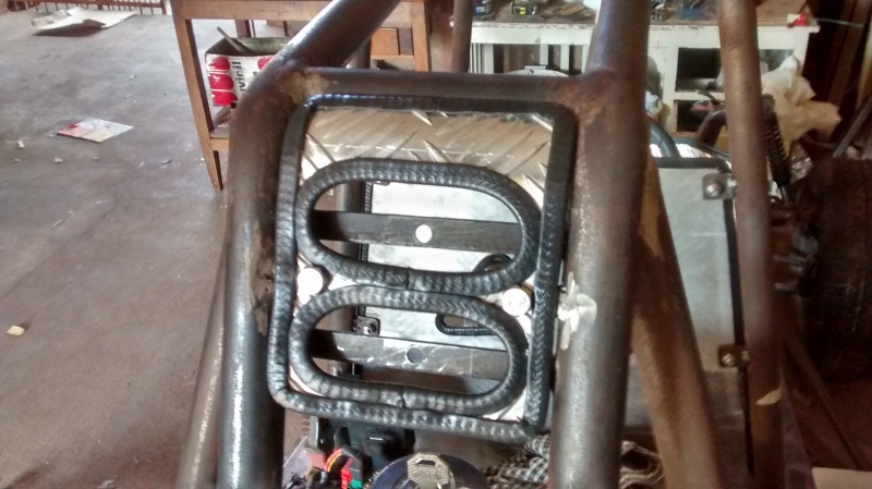

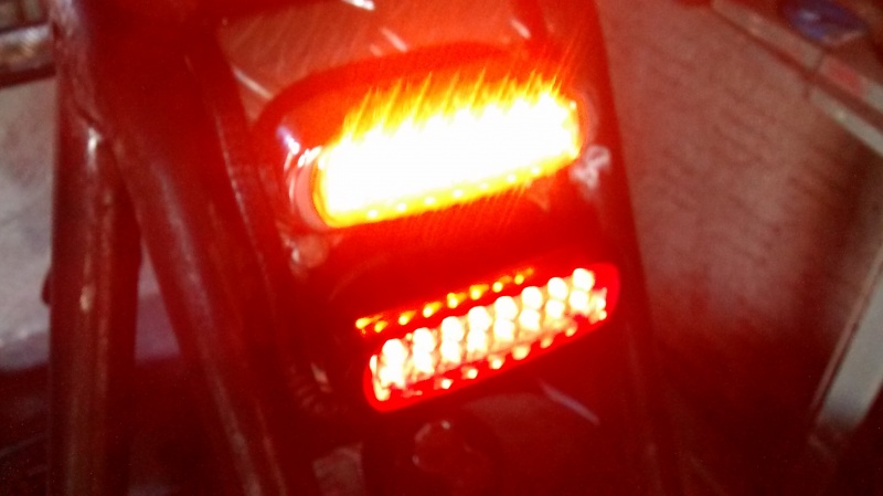

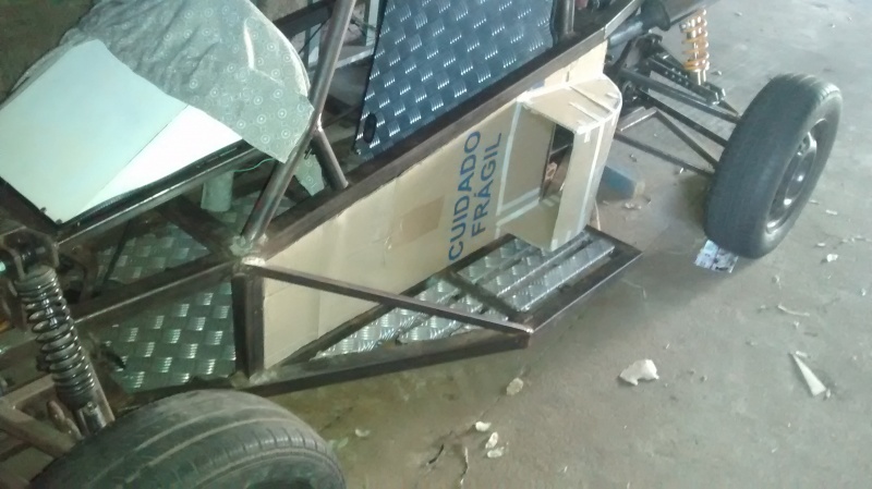

  • #495

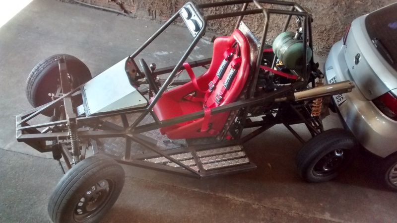

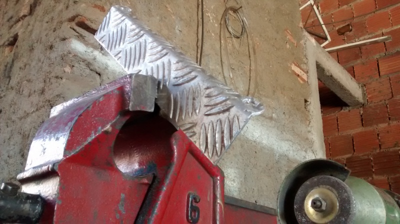

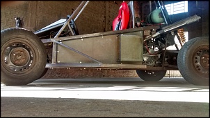

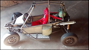

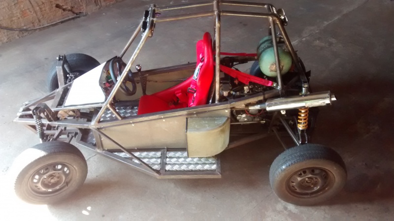

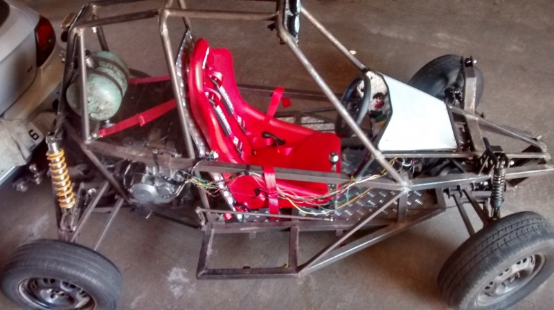

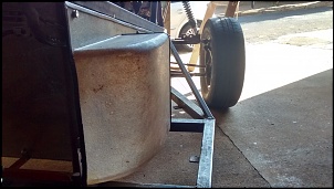

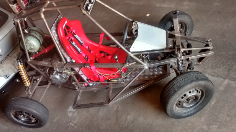

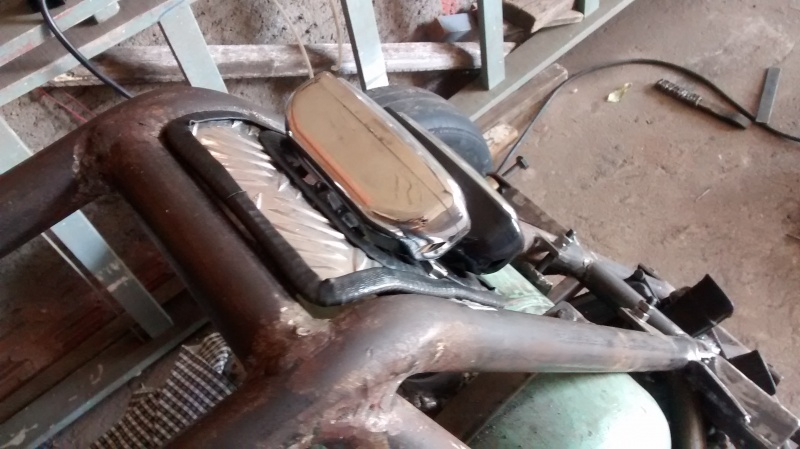

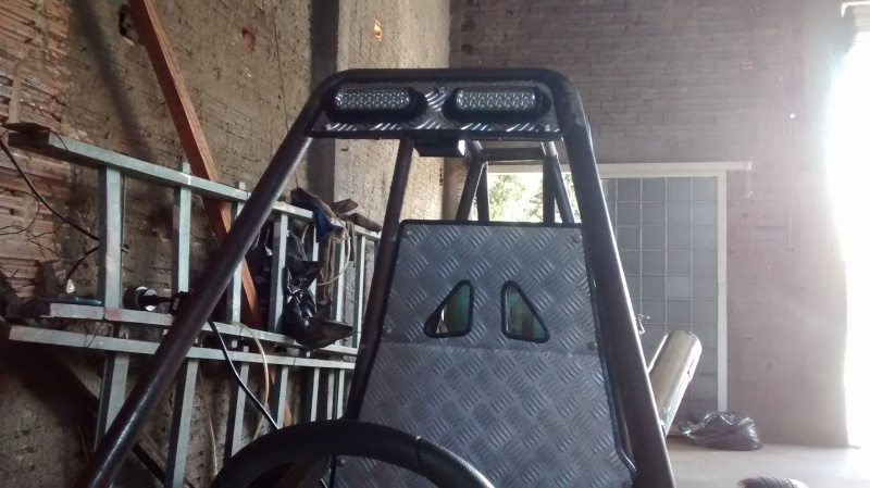

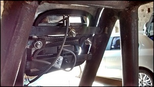

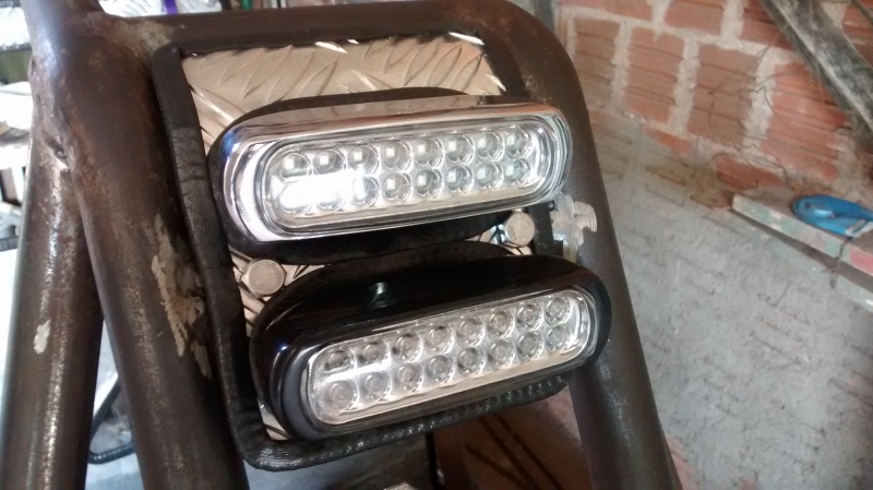

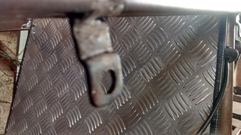

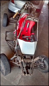

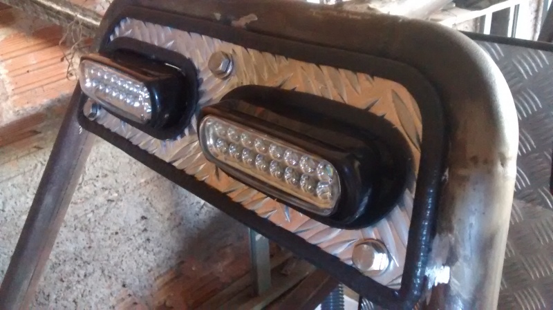

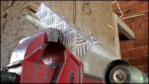

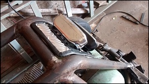

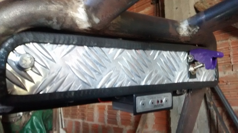

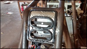

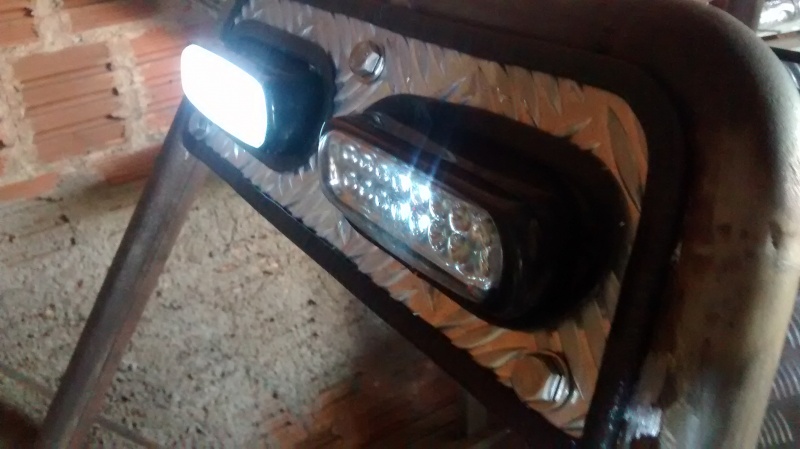

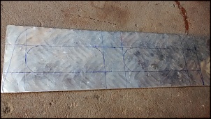

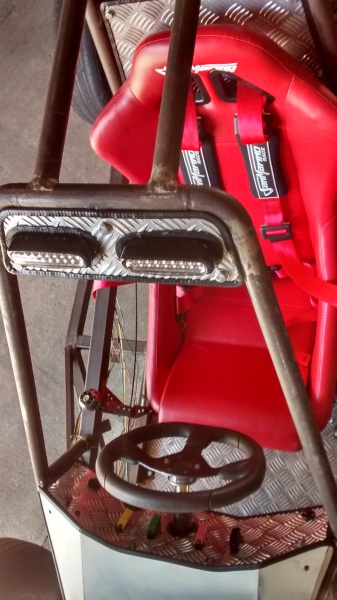

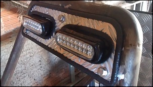

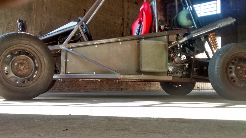

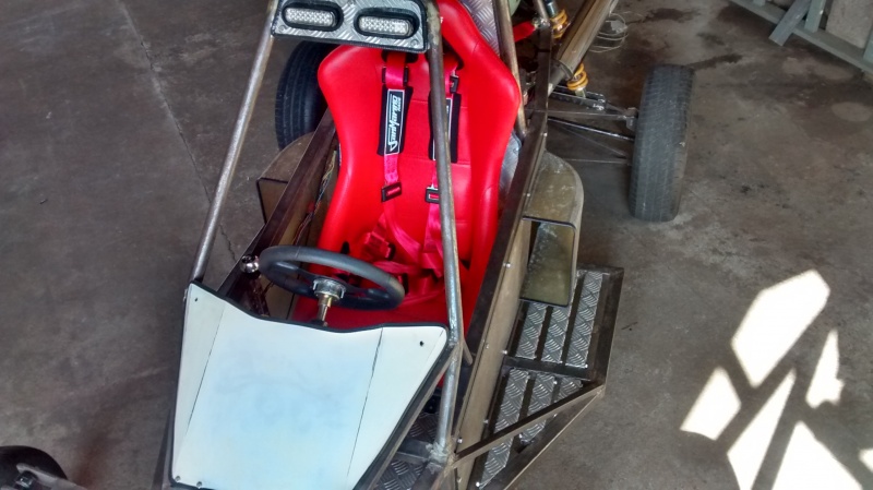

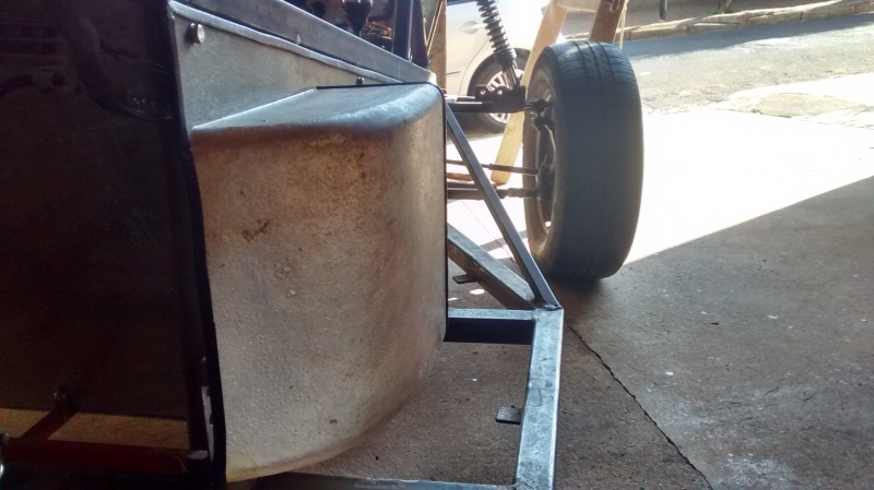

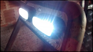

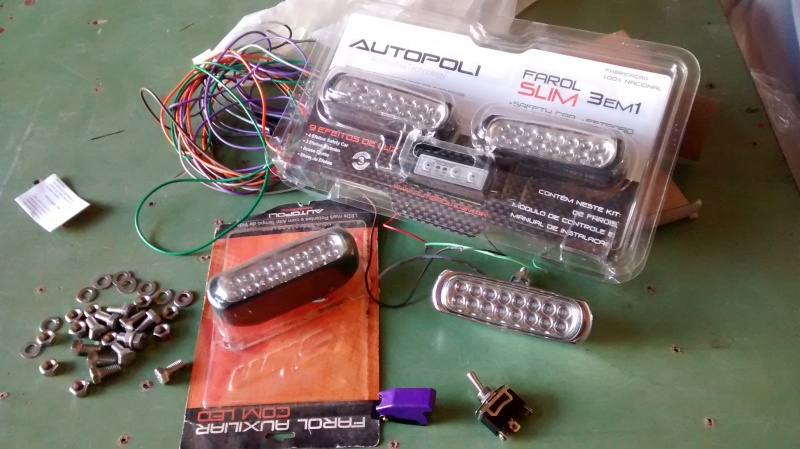

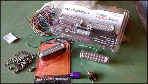

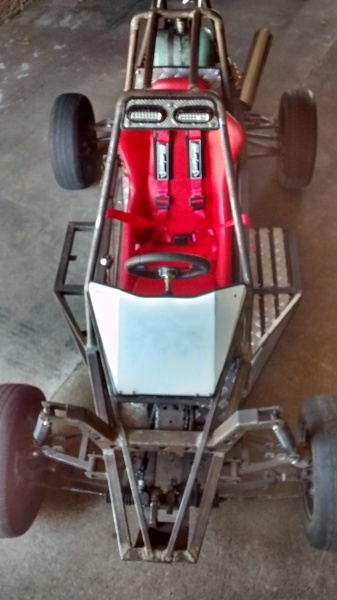

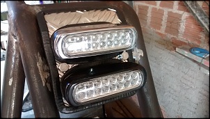

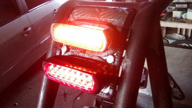

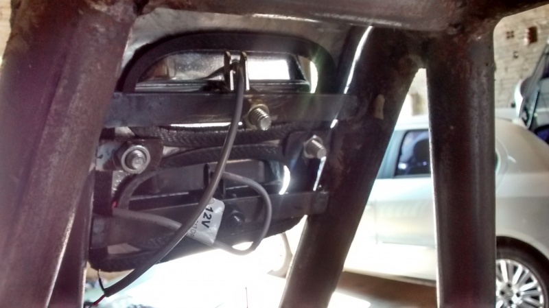

    Kart Coss 250cc Farol strobo safety car
    Kart cross /catanduva-sp/junior ferrareze-25.jpgKart cross /catanduva-sp/junior ferrareze-26.jpg
    Kart cross /catanduva-sp/junior ferrareze-28.jpgKart cross /catanduva-sp/junior ferrareze-29.jpg
    Anexo 534006Anexo 534008
    Kart cross /catanduva-sp/junior ferrareze-36.jpgKart cross /catanduva-sp/junior ferrareze-35.jpg
    Kart cross /catanduva-sp/junior ferrareze-37.jpgKart cross /catanduva-sp/junior ferrareze-38.jpg
    Kart cross /catanduva-sp/junior ferrareze-38a.jpgKart cross /catanduva-sp/junior ferrareze-39.jpg
    Kart cross /catanduva-sp/junior ferrareze-40.jpgKart cross /catanduva-sp/junior ferrareze-41.jpg
    Kart cross /catanduva-sp/junior ferrareze-42.jpgKart cross /catanduva-sp/junior ferrareze-43.jpg
    Kart cross /catanduva-sp/junior ferrareze-44.jpgKart cross /catanduva-sp/junior ferrareze-45.jpg
    Kart cross /catanduva-sp/junior ferrareze-48.jpgKart cross /catanduva-sp/junior ferrareze-47.jpg
    SEMPRE FAÇA O MELHOR ACABAMENTO QUE PUDER!

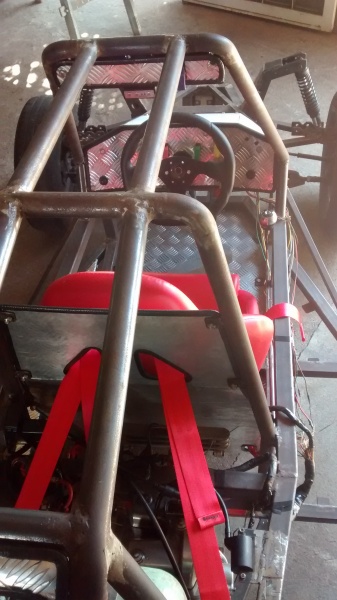

  • #499

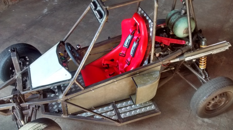

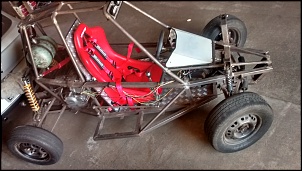

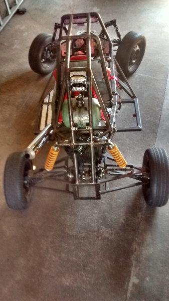

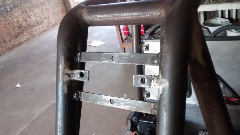

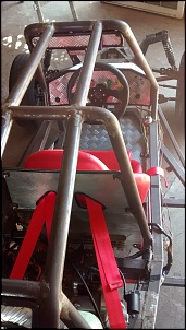

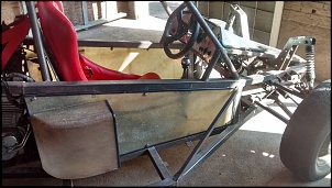

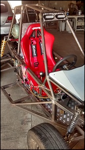

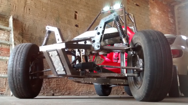

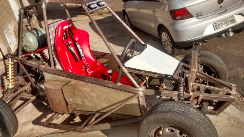

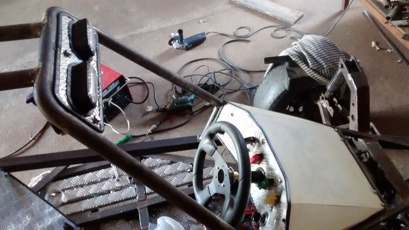

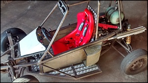

    kart cross 250 cc projeto em andamento
    Kart cross /catanduva-sp/junior ferrareze-10.jpgKart cross /catanduva-sp/junior ferrareze-11.jpg
    Kart cross /catanduva-sp/junior ferrareze-12.jpgKart cross /catanduva-sp/junior ferrareze-13a.jpg
    Kart cross /catanduva-sp/junior ferrareze-14.jpgKart cross /catanduva-sp/junior ferrareze-17.jpg
    Kart cross /catanduva-sp/junior ferrareze-19.jpgKart cross /catanduva-sp/junior ferrareze-22.jpg
    Kart cross /catanduva-sp/junior ferrareze-23.jpgKart cross /catanduva-sp/junior ferrareze-26.jpg
    Kart cross /catanduva-sp/junior ferrareze-8.jpgKart cross /catanduva-sp/junior ferrareze-9.jpg
    sempre faça o melhor acabamento que puder!

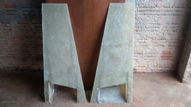

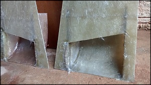

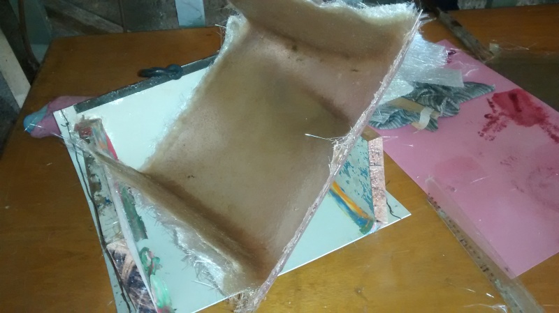

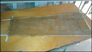

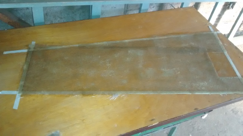

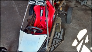

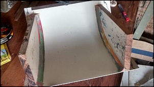

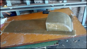

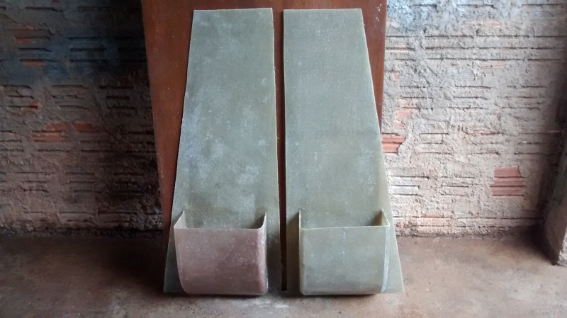

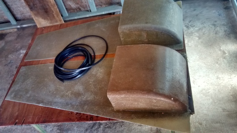

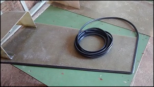

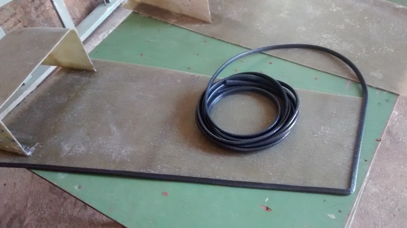

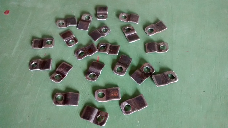

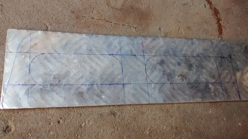

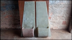

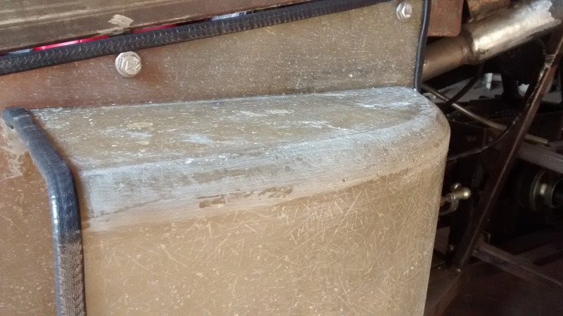

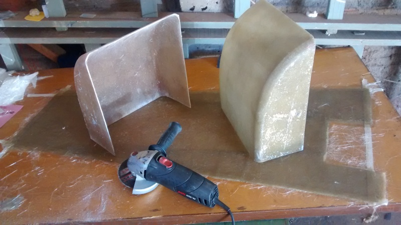

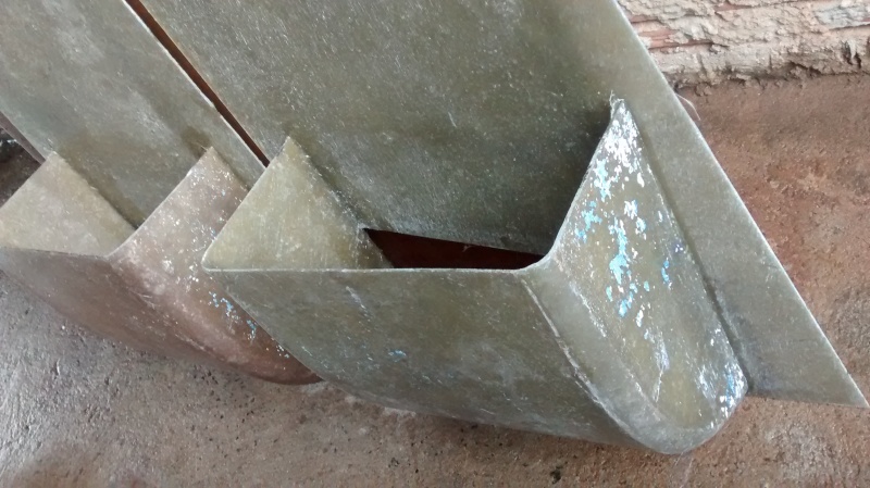

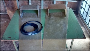

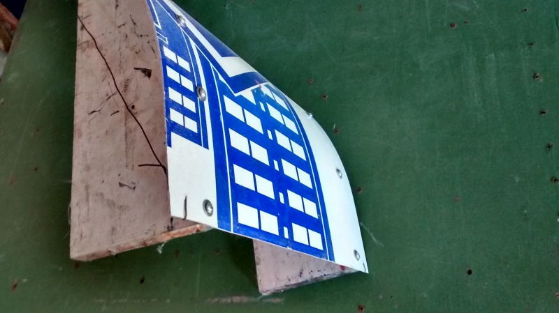

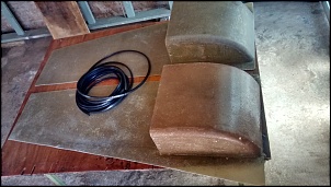

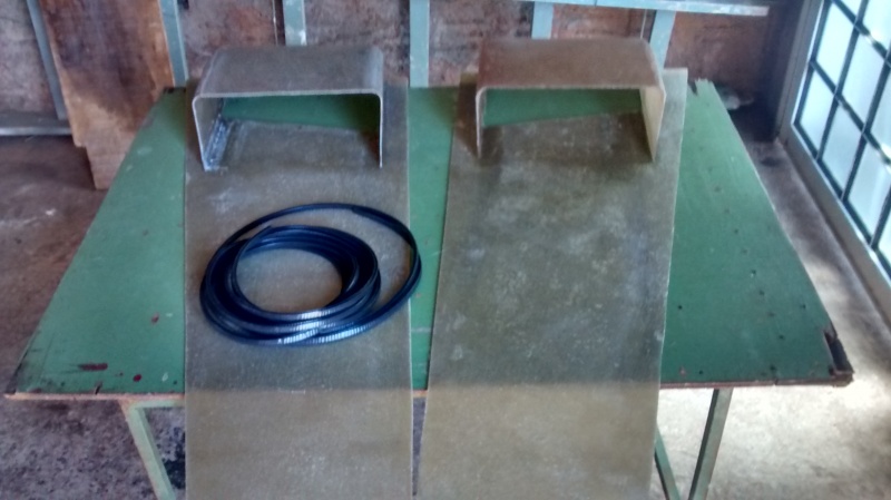

    Kart Cross 250cc projeto carenagem
    Kart cross /catanduva-sp/junior ferrareze-1.jpgKart cross /catanduva-sp/junior ferrareze-2.jpg
    Kart cross /catanduva-sp/junior ferrareze-2a.jpgKart cross /catanduva-sp/junior ferrareze-3.jpg
    Kart cross /catanduva-sp/junior ferrareze-4.jpgKart cross /catanduva-sp/junior ferrareze-5.jpg
    Kart cross /catanduva-sp/junior ferrareze-6.jpgKart cross /catanduva-sp/junior ferrareze-7.jpg
    Kart cross /catanduva-sp/junior ferrareze-12.jpgKart cross /catanduva-sp/junior ferrareze-13.jpg
    Kart cross /catanduva-sp/junior ferrareze-20.jpgKart cross /catanduva-sp/junior ferrareze-14.jpg

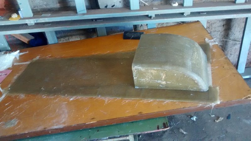

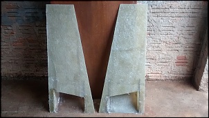

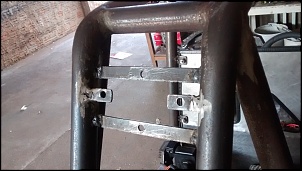

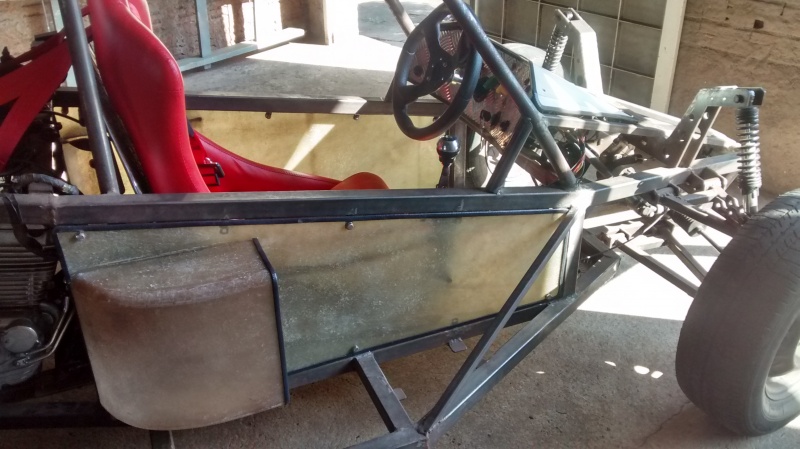

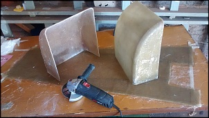

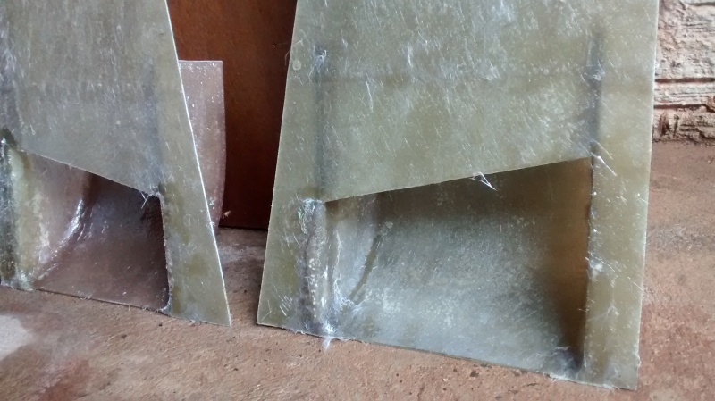

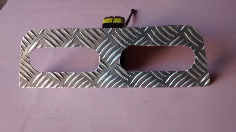

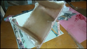

    Kart cross /catanduva-sp/junior ferrareze-29.jpgKart cross /catanduva-sp/junior ferrareze-29.jpg
    Kart cross /catanduva-sp/junior ferrareze-15.jpgKart cross /catanduva-sp/junior ferrareze-16.jpg
    Kart cross /catanduva-sp/junior ferrareze-21.jpgKart cross /catanduva-sp/junior ferrareze-22.jpg
    Kart cross /catanduva-sp/junior ferrareze-23.jpgKart cross /catanduva-sp/junior ferrareze-25.jpg
    Kart cross /catanduva-sp/junior ferrareze-26.jpgKart cross /catanduva-sp/junior ferrareze-28.jpg
    Kart cross /catanduva-sp/junior ferrareze-29.jpgKart cross /catanduva-sp/junior ferrareze-30.jpg
