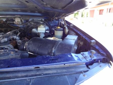

    Parte interna da instalação do snorkel
    F1000 4x4 - Milona-dsc01499.jpgF1000 4x4 - Milona-dsc01495.jpgF1000 4x4 - Milona-dsc01496.jpgF1000 4x4 - Milona-dsc01497.jpgF1000 4x4 - Milona-dsc01498.jpg

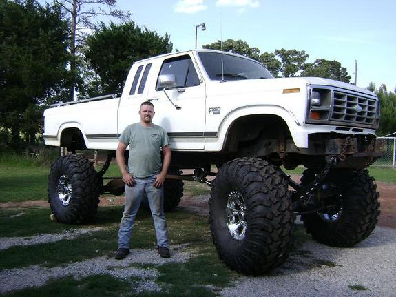

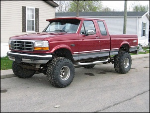

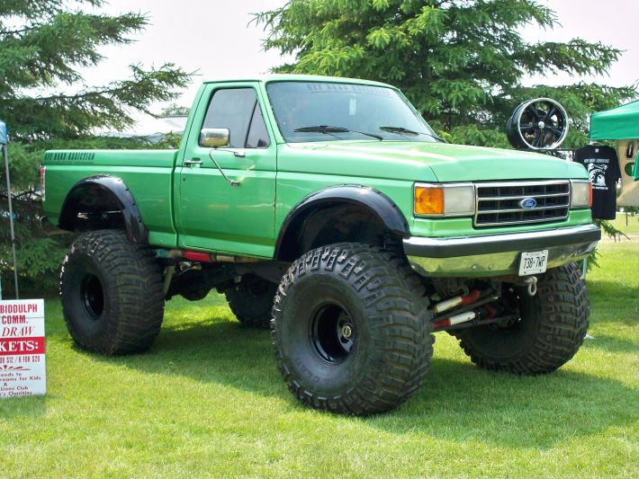

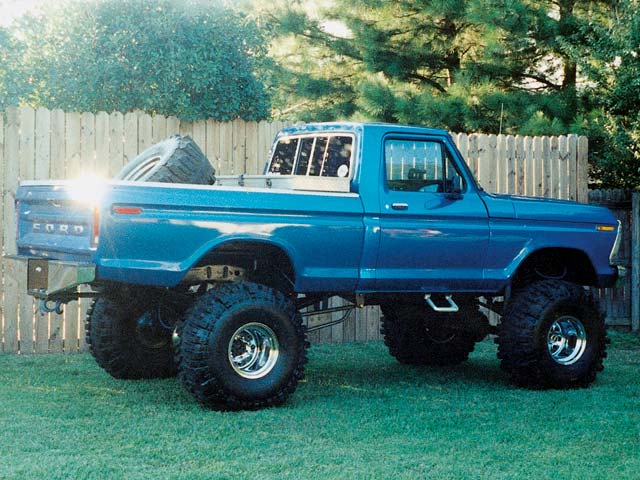

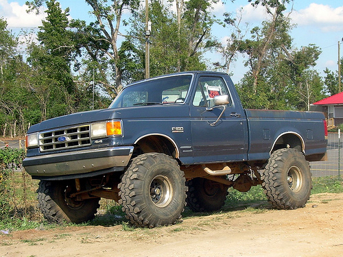

  • #3680
    F-series.....
    F1000 4x4 - Milona-fseries3.jpgF1000 4x4 - Milona-fseries5.jpgF1000 4x4 - Milona-fseries6.jpgF1000 4x4 - Milona-fseries7.jpgF1000 4x4 - Milona-fseries8.jpg
    Algumas imagens inspiradoras......
    []s com Duendes a milhão
    fuck the fuel economy
    PU9-EDC - Pajero GLS-B 3.0 V6
