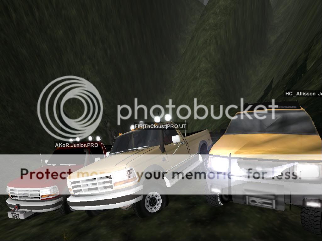

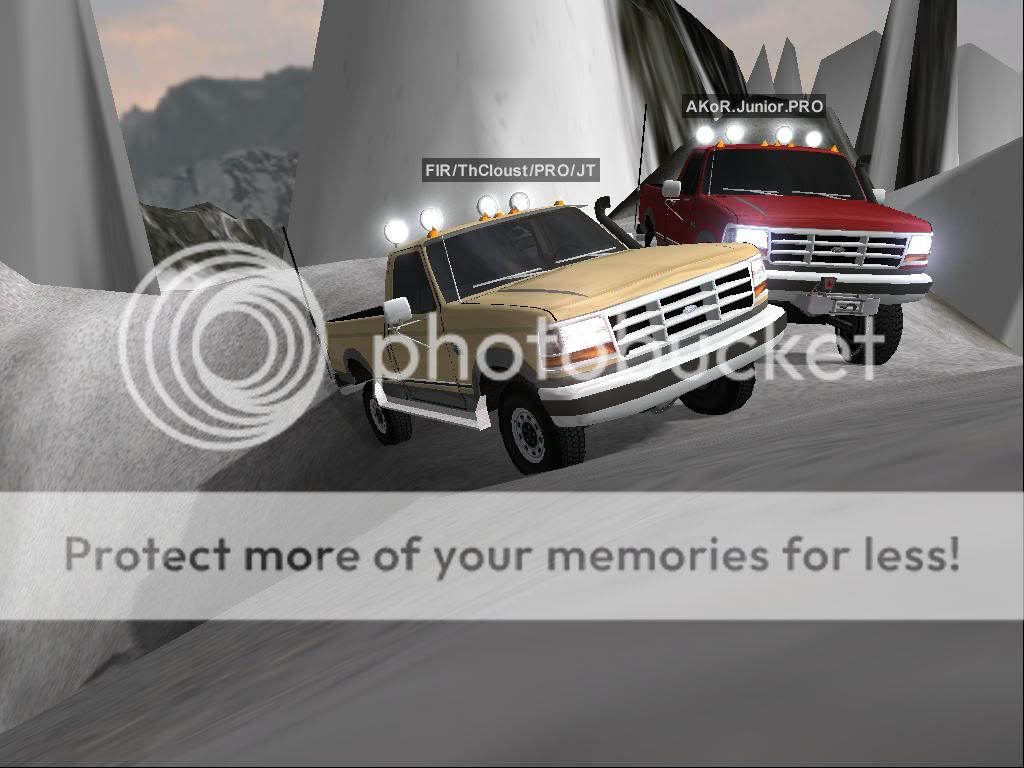

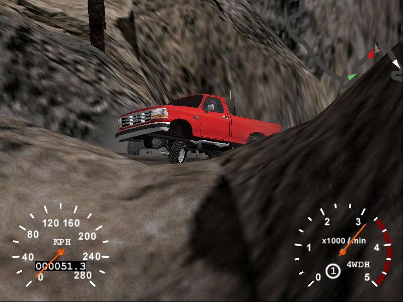

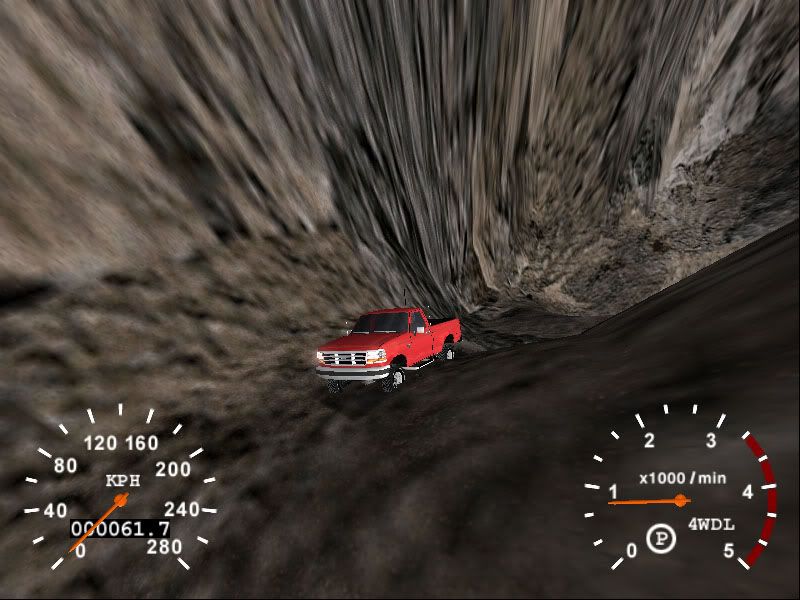

    Off topic:
    Femil virtual
    Okay, parei
