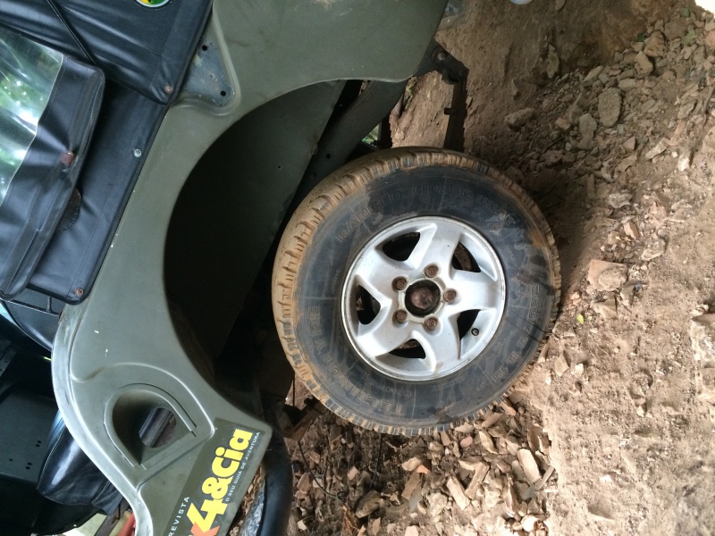

    Matheus Berçan - Jeep CJ-5 1973
    GRUPOS WHATSAPP JEEP WILLYS/FORD
    https://m.facebook.com/grupowillysford
