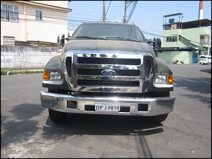

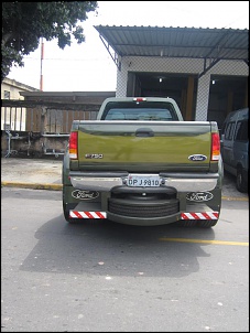

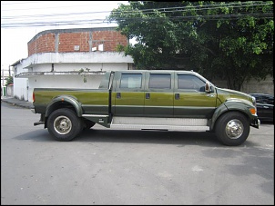

    Ola amigos
    Agora pronta faltando somente acertar a suspensão da cabine para circular tranquilo F12000 VIRA F750 Cabine tripla-img_0440.jpgF12000 VIRA F750 Cabine tripla-img_0447.jpgF12000 VIRA F750 Cabine tripla-img_0438.jpgF12000 VIRA F750 Cabine tripla-img_0442.jpg forrar o teto e acertar a mola dianteira esquerda que esta um pouco arriada
    Vamos chegando lá>>>>>>>>>>>>>>>>>>>>>>>>>>>>>>>>>>>>>>>>>>>>>>>> >>
    SDS
