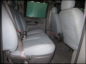

    Galera
    O tempo tá curto e agora legalizando
    fotos do interiorF12000 VIRA F750 Cabine tripla-img_0465.jpgF12000 VIRA F750 Cabine tripla-img_0468.jpgF12000 VIRA F750 Cabine tripla-img_0466.jpgF12000 VIRA F750 Cabine tripla-img_0464.jpg
