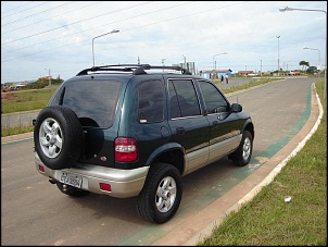

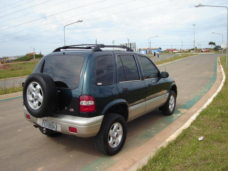

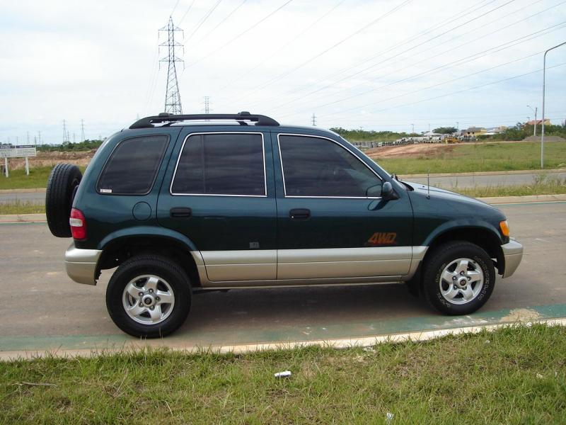

    Foto da SPT com o lift:
    Junior - Pajero FULL 2001 3.0 V6 - Lift 3' - Espaçadores AVM - Pneus Marshal Road Venture MT 285/75 R16
