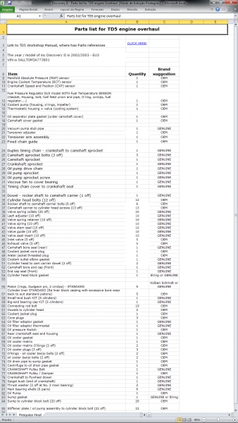

    O primeiro item que está sendo revisado e todo refeito é o Motor.
    Como é um motor muito bom, vale a pena a Obra....
    Só não sai barato..
    mas vamos em frente!

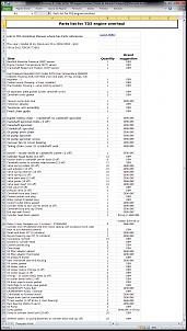

    Aí vai a lista de peças que estou cotando..
    Miniaturas de Anexos Miniaturas de Anexos -lista-de-pecas-para-reforma-completa-do-motor-td5-da-discovery-2.jpg

    Lista de peças para retífica completa do motor da Discovery 2 com motor TD5
    Link to TD5 Workshop Manual, where has Parts references CLICK HERE!
    The year / model of my Discovery II is 2002/2003 - EU3
    VIN is SALLTGM3A773801
    Item Quantity Brand
    Manifold Absolute Pressure (MAP) sensor 1 OEM
    Engine Coolant Temperature (ECT) sensor 1 OEM
    Crankshaft Speed and Position (CKP) sensor 1 OEM
    Fuel Pressure Regulator EU3 model WITH Fuel Temperature SENSOR (Gasket, Housing, bolt, fuel feed union and pipe, O'ring, circlips, fuel regulator....) 1 OEM
    Coolant pump (housing, o'rings, impeller) 1 OEM
    Thermostatic housing + valve (cooling system) 1 OEM
    Oil separator plate gasket (under camshaft cover) 1 OEM
    Camshaft cover gasket 1 OEM
    Vacuum pump stub pipe 1 GENUINE
    Tensioner adjuster 1 OEM
    Tensioner arm assembly 1 OEM
    Fixed chain guide 1 OEM
    Duples timing chain - crankshaft to camshaft sprocket 1 GENUINE
    Camshaft sprocket bolts (3 off) 3 GENUINE
    Camshaft sprocket 1 GENUINE
    Crankshaft sprocket 1 GENUINE
    Oil pump drive chain 1 GENUINE
    Oil pump sprocket 1 GENUINE
    Oil pump sprocket screw 1 GENUINE
    Viscous fan to cover bearing 1 GENUINE
    Timing chain cover to crankshaft seal 1 GENUINE
    Dowel - rocker shaft to camshaft carrier (1 off) 1 GENUINE
    Cylinder head bolts (12 off) 12 OEM
    Rocker shaft to camshaft carrier bolts (6 off) 6 OEM
    Camshaft carrier to cylinder head screws (13 off) 13 OEM
    Valve spring collets (20 off) 20 GENUINE
    Lash adjuster (10 off) 10 GENUINE
    Valve spring retainer (10 off) 10 GENUINE
    Valve spring (10 off) 10 GENUINE
    Valve stem seal (10 off) 10 GENUINE
    Valve guide (10 off) 10 GENUINE
    Valve seat insert (10 off) 10 GENUINE
    Inlet valve (5 off) 5 OEM
    Exhaust valve (5 off) 5 OEM
    Camshaft bore seal (rear) 1 GENUINE
    Coolant jacket core plug 1 OEM
    Water jacket threaded plug 1 OEM
    Coolant outlet elbow gasket 1 GENUINE
    Cylinder head to cam carrier dowel (2 off) 2 GENUINE
    Camshaft bore end cap (front) 1 GENUINE
    End cap seal (front) 1 GENUINE
    Cylinder head block gasket 1 Elring or GENUINE
    Piston (rings, Gudgeon pin, 2 circlips) - STANDARD 5 Kolben Schmidt or GENUINE
    Cylinder liner STANDARD (Re liner block casting with excessive bore wear back to suit standard pistons) 5 OEM
    Small-end bush KIT (5 cilinders) 1 GENUINE
    Big-end bearing cap KIT (5 cilinders) 1 GENUINE
    Connecting rod bolt 10 OEM
    Dowels to cylinder head 2 OEM
    Coolant jacket plug 1 OEM
    Core plugs 3 OEM
    Oil filter adaptor gasket 1 GENUINE
    Oil filter adaptor thermostat 1 GENUINE
    Oil pressure Switch 1 OEM
    Rear crankshaft seal and housing 1 GENUINE
    Oil cooler gasket 1 OEM
    Oil cooler matrix 1 OEM
    Oil cooler matrix O'Rings (2 off) 2 OEM
    Oil cooler plugs (3 off) 3 OEM
    O'Rings - oil cooler banjo bolts (2 off) 2 OEM
    Oil drain pipe to sump gasket 1 OEM
    Centrifuge to oil drain pipe gasket 1 OEM
    CRANKSHAFT Pulley Bolt 1 GENUINE
    CRANKSHAFT Pulley / Damper 1 OEM
    Crankshaft to flywheel dowel 1 GENUINE
    Spigot bush (end of crankshaft) 1 GENUINE
    Thrust washer (2 off at No. 3 main bearing) 2 GENUINE
    Main bearing shells (6 pairs) 6 GENUINE
    Oil Pump 1 OEM
    Sump gasket 1 GENUINE or Elring
    Sump to cylinder block bolt (20 off) 20 OEM
    Stiffener plate / oil pump assembly to cylinder block bolt (22 off) 22 OEM

    Salve salve LAURO!!
    Pois é meu amigo... o motorzão vale a pena, eu sei!
    o duro é que o consignado é mais curto que o custo final das peças
    kkkk
    agora é cortar o que der para cortar... essa é a parte difícil.. fazer algo bem feito, de forma que encaixe nos boolsos..
    qualquer novidade, registrarei aqui.. é que no momento estou analisando a lista de peças
