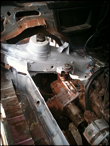

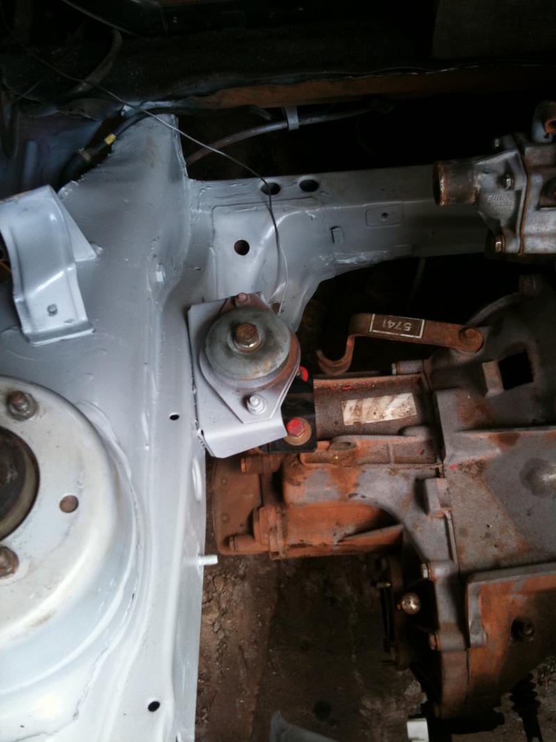

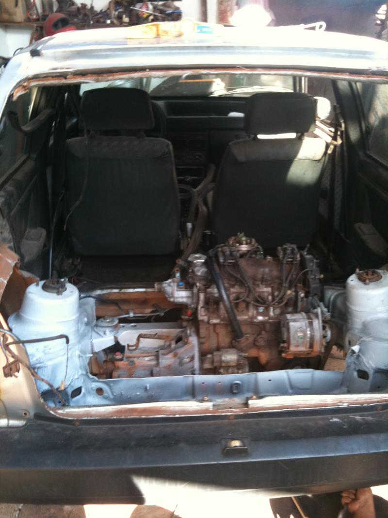

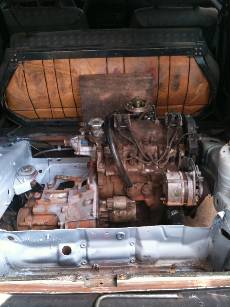

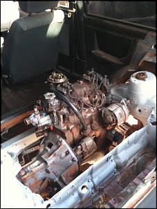

    gaiola uno 1.6-img_0263.jpggaiola uno 1.6-img_0257.jpggaiola uno 1.6-img_0256.jpggaiola uno 1.6-img_0255.jpgfotos melhores

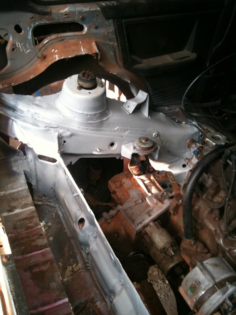

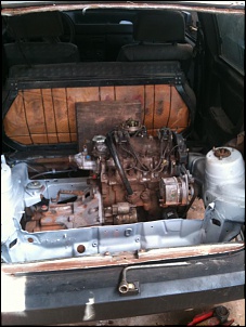

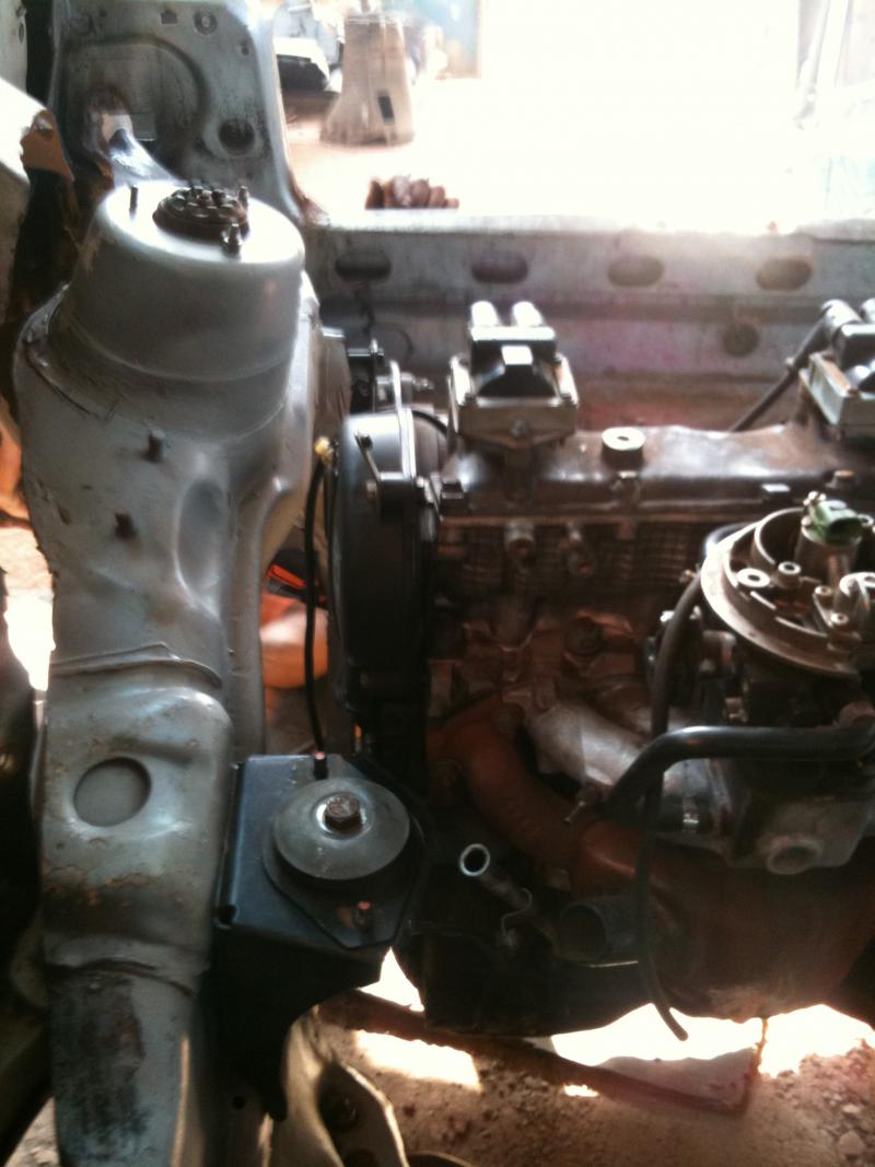

    gaiola uno 1.6-img_0271.jpggaiola uno 1.6-img_0267.jpggaiola uno 1.6-img_0266.jpgmais fotos
