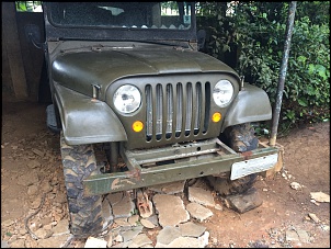

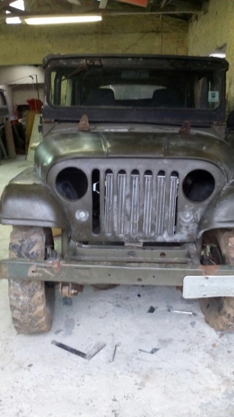

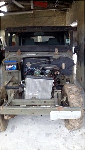

    Depois de quase 10 anos parado estou cuidando do meu Jeep novamente.. Seguem algumas fotos dele onde o mesmo ficou imóvel esse tempo todo
    M38A1 - Pilatti Movel :)-1394654723_574709243_1-jeep-4x4-1958-cj5m38a1-santa-candida.jpg M38A1 - Pilatti Movel :)-1394654723_574709243_2-fotos-de-jeep-4x4-1958-cj5m38a1.jpg M38A1 - Pilatti Movel :)-1394654723_574709243_5-jeep-4x4-1958-cj5m38a1-veiculos.jpg M38A1 - Pilatti Movel :)-1394654723_574709243_9-jeep-4x4-1958-cj5m38a1-.jpg M38A1 - Pilatti Movel :)-1394654723_574709243_10-jeep-4x4-1958-cj5m38a1-.jpgM38A1 - Pilatti Movel :)-1394654723_574709243_12-jeep-4x4-1958-cj5m38a1-.jpg M38A1 - Pilatti Movel :)-1394654723_574709243_11-jeep-4x4-1958-cj5m38a1-.jpg M38A1 - Pilatti Movel :)-1394654723_574709243_13-jeep-4x4-1958-cj5m38a1-.jpg M38A1 - Pilatti Movel :)-1394654723_574709243_13-jeep-4x4-1958-cj5m38a1-.jpg
