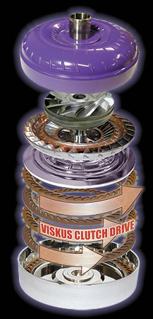

    Uma das empresas a qual vi a propaganda era essa daqui:
    http://www.atsdiesel.com/atswebsite/...nsmissions.asp
    Aqui fala de um outro equipamento, não era o mesmo que vi nas revistas, mas também acopla em 100% o torque.
    http://www.atsdiesel.com/ATSWebsite/HIWFiveStar.asp
    texto original :
    The ATS Five Star¿ Torque Converter is a revolutionary torque converter that utilizes innovative Viskus Clutch Drive technology while incorporating traditional technologies of conventional Torque Converters.
    The Viskus Clutch Drive, along with the fluid-coupling portion of the torque converter, share in the increase of transfer of power through the torque converter. Unlike other torque converters that rely only on fluid transfer from the impeller to the turbine via the Stator, the Five Star¿ utilizes ATS's Viskus Clutch Drive technology that transfers rotational energy from the engine to the transmission. This "Fluid Assist" technology developed by ATS helps transmit energy to the transmission in conjunction with the fluid-coupling section of the torque converter. This "Fluid Assist" technology results in less stress being placed on the torque converter while simultaneously enhancing the fluid coupling of the torque converter making it more efficient. This added efficiency means less mechanical energy is turned into heat and less heat means that more power is transferred to the Transmission.
    At low speeds the Viskus Clutch Drive design has more effect on power transfer allowing for optimal stall speed. As the engine to transmission RPM differential speed is increased the efficiency of the torque converter increases. When the transmission input speed is near equal to engine speed, fluid is reversed through the Viskus Clutch Drive. The reversal of fluid is commanded by the factory computer or an external lock-up controller such as the Co-Pilot¿. This fluid reversal compresses the five clutch plates providing a 100% mechanical engagement ensuring no plate slippage during lock-up even at power levels in excess of 2000 foot pounds of torque.
    Optimal stall speed, maximum torque multiplication and 100% efficiency is now possible with the innovation of the ATS Five Star¿ Viskus Clutch Drive torque converter. Simply put, the Five Star¿ Torque Converters efficient design equates to higher fuel economy, better performance and unsurpassed reliability.

    Você se refere ao conversor de torque (a peça roxa do desenho enviado pelo haundrich?
