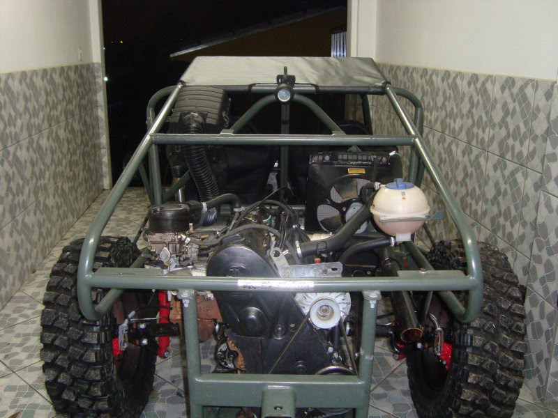

    -ogaaaf88e2jbgajv87-ytja7jistgpfv0sqaqcpel252ki785d5irzkorzqqfv5umuelbf42bl-izvj-e3bs8dvskqkam1t1.jpg-ogaaak-4fiybzfqqdpnppwoliznlu2f7mt88i6kfm6fou7ywqfjwjhpvqli6ozpvehnfmklrwht0uilldkuj68l1qqyam1t1.jpg-ogaaam68whwzwjbcd9awitfgh4uiuv-s4mbzvugjcjzzwzj5arummcxckemmjglktfpbb3_i9vnvp_-th_bu5qelvzeam1t1.jpg-ogaaamc3yz9kduxe579ckse-emundrjcycqmz6n8brzwf5bjneagarspibbqofkfgxqgu2qd2bgk9yzxqkijt-k7hncam1t1.jpg-ogaaamowk5rk8wtphvptiuikaislluagzwiunfurzx08d9q34nj-puknlredid3byhfy6lthnnnwqnve-bdmhvbf__kam1t1.jpgvaleu! axo que aprendi!
