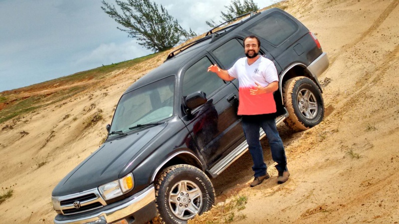

    Black Bull.
    Ano 2000, 325.000 km.
