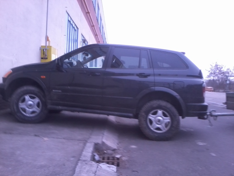

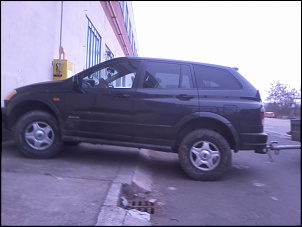

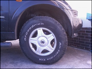

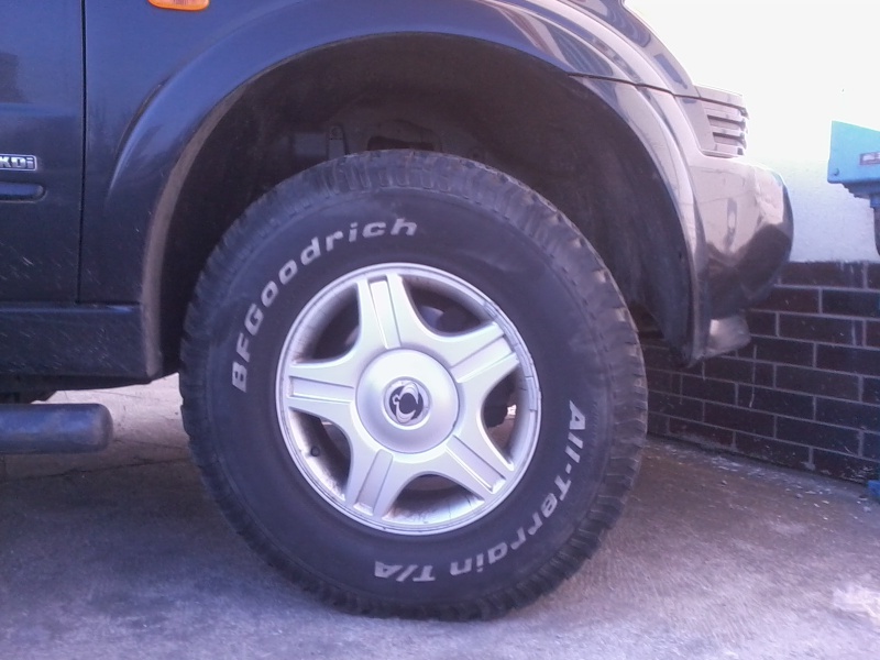

    Para começar, Fotos de um lift de 4":
    -1151_252_ssangyong-kyron-4-inch-lift-2.jpg-1168_252_kyron-mt-4-inch-lift.jpg-1154_252_kyron-14-cm.jpg-1156_252_ssangyong-kyron-4-inch-lift-1.jpg-1153_252_kyron-14cm.jpg-1129_252_kyron-po-2-palcovem-liftu-.jpg-1154_252_kyron-14-cm.jpg

    Inclinação lateral:
