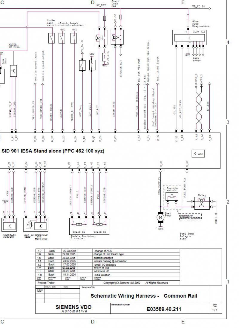

Achei esse conector que possivelmente faz a leitura (FORBMW INPA K+CAN - 2 linhas K e D):
MWM INPA K+CAN
Tipo de Conector: OBD CAN
Central de Injeção (ECU): Siemens SID 901K
ECU da Ranger:
Central de Injeção (ECU): Siemens SID 901C

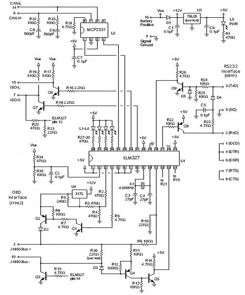

Links Úteis:
OBD II CAN bus pinout and wiring @ pinoutsguide.com
Computador de bordo via OBDII | Clube da Graxa
16 pin J1962 OBD-2 car proprietary connector diagram and applications @ pinouts.ru
http://www.4x4brasil.com.br/forum/je...cs-system.html
Ford OBD-II diagnostic interface pinout and wiring @ pinoutsguide.com (pinagem da ford)
OBD-2 universal diagnostic cable scheme for ISO 15765-4 CAN, SAE J1850 PWM, SAE J1850 VPW, ISO 9141-2, ISO 14230-4 and SAE J1939 pinout and wiring @ pinoutsguide.com (Esquema do conexão no cabo)
On-board diagnostics - Wikipedia, the free encyclopedia
http://www.ravenscanner.com.br/monta...tadora=TROLLER
Raven Scanner Diesel

Pinagem ISO 15765-4 (CAN-BUS) and SAE-J2234:
The most modern protocol, mandatory for all 2008+ vehicles sold in the US. Uses pins 6 and 14, communication is differential.
Pin 4 - Chassis Ground
Pin 5 - Signal Ground
Pin 6 - CAN High
Pin 14 - CAN Low
Pin 16 - Battery power (+12v)

Por ser um motor fabricado na europa, ele deve ser um EOBD-CAN com pinagem de J1962/ISO9141/14230/ISO15765.
