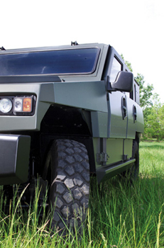

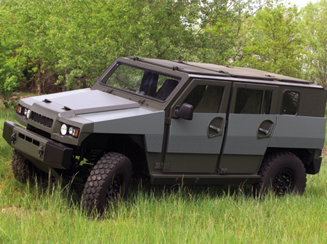

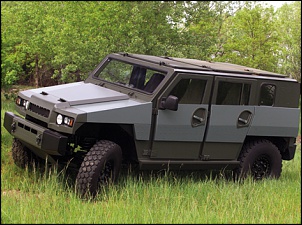

    Pessoal navegando na internet achei no site da PANHARD (que pertence a Auverland (Mãe jo JPX ))essa versão Francesa do Hummer.
    O site é bem legal!!!!
    www.panhard.fr/francais/index.htm
    Ficha Técnica:
    TYPE A4 FAST, Wheelbase : 3 000 mm
    CHASSIS Tubular chassis with 120 x 60mm and 140 x 60mm rectangular tube
    BODY 10/10mm steel metal body - AP mine protected floor (DM 31 type)
    DIMENSIONS
    Overall length 4 456 mm
    Overall width 1 970 mm
    Overall height 1 950 mm
    Wheelbase 3 000 mm
    Front and rear track 1 640 mm
    Ground clearance 312 mm
    WEIGHT
    Tare weight 2 700 kg
    Gross Vehicle Weight 4 000 kg
    Payload 1 300 kg
    Weight on front axle 2 000 kg
    Weight on rear axle 2 500 kg
    ENGINE Brand / Type
    Engine architecture
    Injection type
    Bore x Stroke
    Displacement
    Maximum power
    Maximum torque
    Fuel IVECO / Turbo Diesel
    4 cylinders in line
    Direct injection
    94,4 x 100 mm
    2 800 cc
    107 Kw (146hp) (a) 3 600 Rpm
    320 Nm (a) 1 500 Rpm
    Diesel
    PERFORMANCES Maximum speed
    Approach angle
    Departure angle
    Slide slope
    Gradient
    Fording
    Range
    130 Km/h
    60°
    48°
    40°
    100 %
    533 mm
    800 Km
    GEAR BOX 5 speed gearbox
    TRANSFER BOX Brand / Type
    Ratio AUVERLAND / A.80 R
    Non permanent 4 wd
    configuration with 2 speed
    transfer case
    AXLES Type
    Differential Rigid
    Rear differential lock
    SUSPENSION Front and rear Coil springs and hydraulic shock absorbers
    Anti roll bar
    BRAKES Type Servo assisted / ABS / Anti Skid system
    Disk brakes
    STEEERING Principe Powered steering / Turning radius : 6,50m
    FUEL TANK Capacity 135 l
    ELECTRICAL
    EQUIPMENT Instruments and black out lights in 24 volts /
    Engine electronic in 12 volts (12/24 v converter)
    24 volts Alternator and Starter /
    Interference suppressor EG 13
    TYRES 255 / 100 R 16
    CREW 2 to 4 men depending on missions
    STANDARD
    EQUIPEMENT
    Gearbox / Transfer protection
    OPTIONS
    Automatic gearbox
    Electric winch
    Slave socket
    Central Tyre Inflation System
    Reinforced interference suppressor
    Armour kit
    Weapons provision
    Right hand drive version
    A Caixa de Transferência é a mesma do JPX
