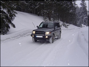

    Pajero Pinin 2,0 - Europe, Slovakia
    ...this is my Pajero Pinin. What you are saying????

    ... another foto :-)

    Citação Postado originalmente por fiberopt Ver Post
    beautiful... I see you guys like snow around Slovakia!
    Does this vehicle come with some kind of traction control? like automatic differential locking and stuff? or even manual differential lock?
    This AT tires go well on snow?

    Citação Postado originalmente por n0gs Ver Post
    Greetings from Brasil...
    ...thanks all for greetings..
    My Pinin is the same as Japan Pajero IO, your TR4 has got little diferent motor (you have classic MPI and we have GDI). Pinin has got system superselect SS4-i 4WD with manual lock central differential. Rear differential has got LSD lock system. The australian ARB produce manual rear lock differential for this type. ... maybe later
    I use tires BFG AT all season. It's good on the snow but it has got trouble with brake on ice
    Greetings from Slovakia ...
