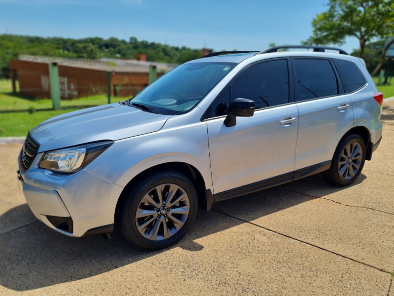

    Quase pronta as modificações na XT
    SUBARU FORESTER XT 2018
    Ex: Dodge Ram 2009 / Troller 2010 / Ford Ranger Limited 2012 / GM S10 LT 4X4 2014 / FXT 2015
